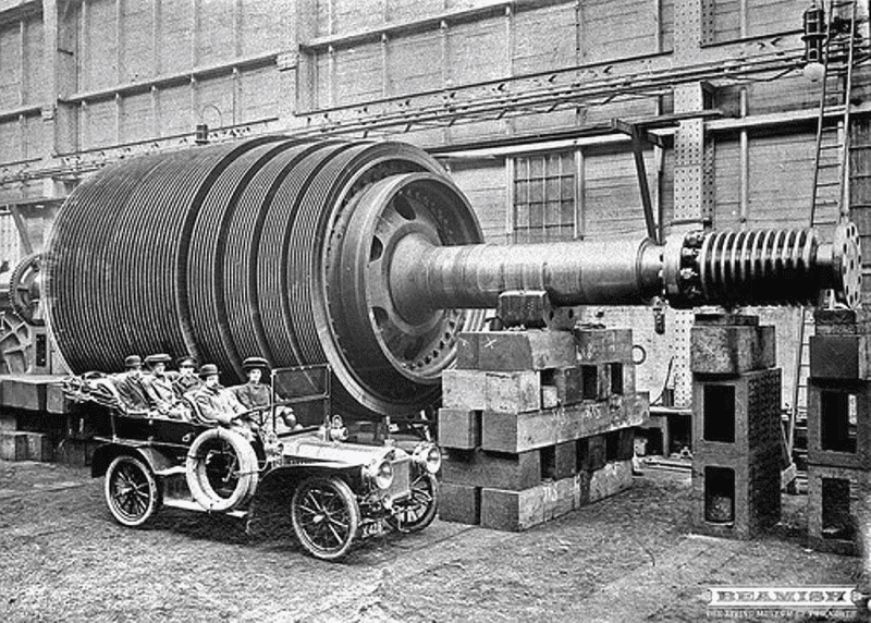

Exxon didn't trust us to do much turbine work and farmed most of it out....Yeah, that's the nice thing about working on big stuff, setup takes a long time and alot of my
projects took months to machine. Crashed Turbines had to be stripped, runouts taken, stress
relieved, welded, stress relieved again, blasted, and machined. Then new "Buckets" were installed.
Lots of "Butt Time". I learned alot and it was always fun.
