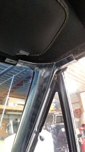

I have a 67 belvedere I can't get the A-PILLAR trim off it slides up and down it's loose but I can't get it to come off
so you have the screws out and it moves up and down. door is open and push down and pull out on the top it should come out.
  • Thanks it was caught on the clip the screw goes in I appreciate the help
