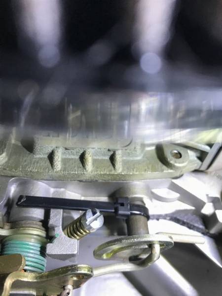

I see a lot of threads on various forums where someone is trying to figure out if their Holley vacuum secondaries are really opening or not. Since they operate off I’d venturi vacuum and engine load trying to verify their operation is not really something that can be done in the driveway easily. This is one way to find out. This is on my ERA Cobra but all vacuum secondary Holleys operate basically the same way. Here is a zip tie fastened on the secondary throttle shaft and at rest, leaning forward with the secondaries closed. The zip tie needs to be pulled tight on the shaft so it has a friction fit.

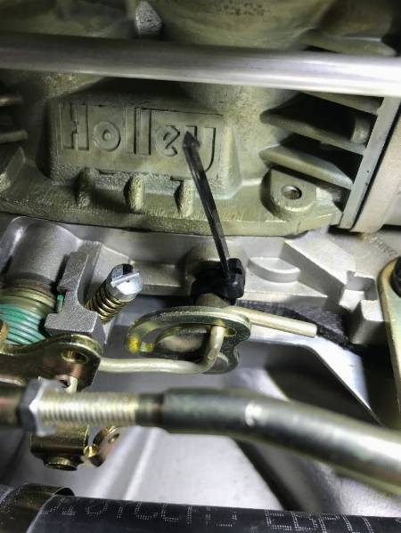

At the primary throttle is opened up the bent link rod pulls forward in the slotted arm which lets the secondary throttle blades open up when venturing vacuum is high enough to activate the diaphragm pull on the other side that opens them. If after a drive and a good hard acceleration pull (probably 2nd or 3rd gear is best) the throttle shaft will rotate CCW inside the zip tie since it is resting on the carb body and cannot move. And when the throttle is released and the shaft will rotate back CW, the zip tie will now ride back with it in the CW direction and end up sticking approximately straight up if the secondaries opened fully. An easy tattletale to verify operation.

Couldn’t you put say a paper clip on the vac secondary diaphram shaft down low and drive and mash the pedal and see if the paper clip moved upwards after returning?
I don’t see why something like that wouldn’t work to as long as it would slide pretty easily but stay in place one the throttle is backed off.

Years ago I took a piece of styrofoam from a cup, cut it to a size of a quarter, poked a small hole, then cut a slit in it. Fastened it the the diaphragm shaft (making sure it was snug) then drove the car. Worked like a charm. Hey, this should be my Shark Tank idea. I’m gonna be rich! It was nice knowing you all. Just kidding of course The zip tie idea is nice as well
