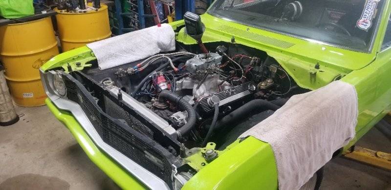

Hey guys,
I've got a 1970 GTX. I pulled the 1972 engine out of the car and swapped it into my drag dart. The engine needs race gas, and it tends to get hot on summer cruises. At any rate, I'm now on the hunt for a correct date coded 440. My fender tag states "A31" for a date code. I understand this to be Halloween day. My question: Is this Halloween day 1969, or 1970?
Any tips, pointers and suggestions on getting the date date coded 440 will be greatly appreciated.

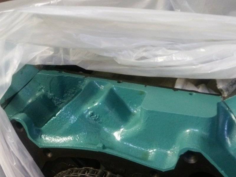

Eldubb, i think you're mistaken, a 440 has a seperate pad in front of the valley cover with tbe numbers, machining the deck wont touch (unlike a chevy). I'm not sure about a b-engine low deck, their numbers are in a different place, i dont know if decking removes them.

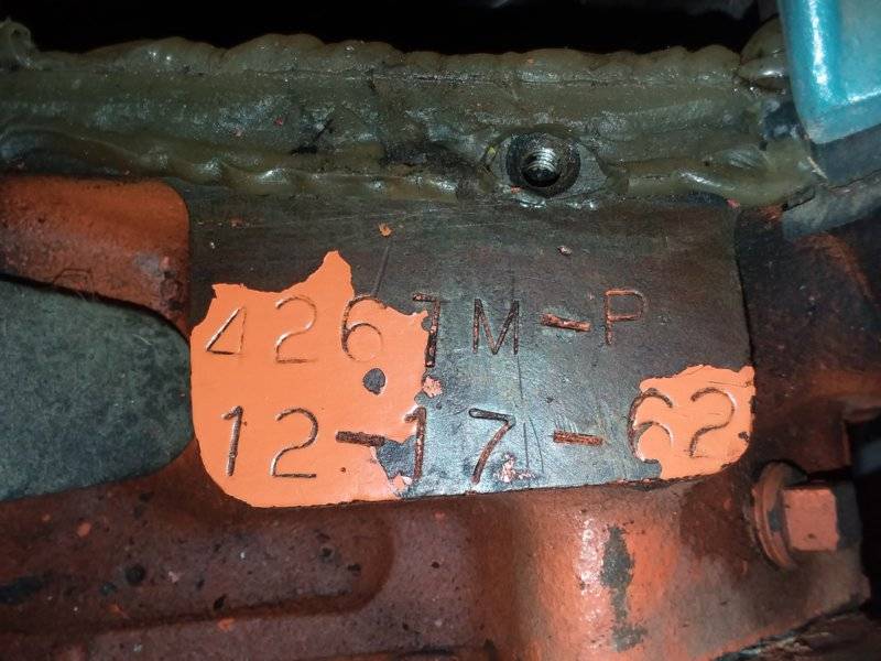

Image is 63 426 wedge block, typical of rb casting.
yeah...... thats what i wondered about....... couldn't that be cut also as a way of fitting the intake?
that being said, i have a date correct non hp block for my gtx...... i painted the pad a little heavy and it made it almost impossible to tell
No, there is no machining procedure that will get anywhere near that pad. The only reason to work on that pad is to change the numbers. The matching vin numbers are on a pad down near the oil pan rail. Changing numbers on the number pad will only make it appear to be date correct.
