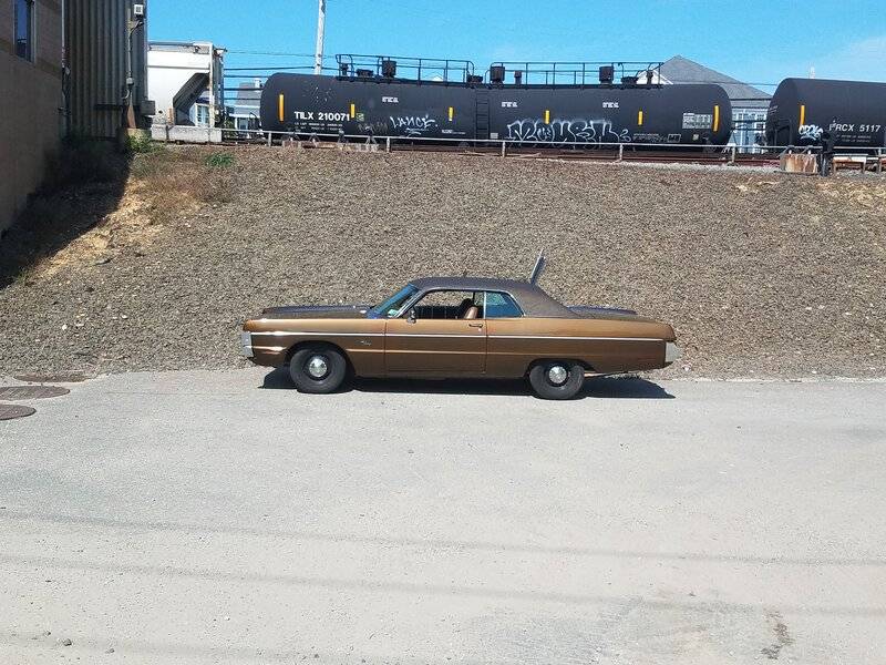

Hello all. I'm about to put an Ultra bell on my A518 for my big block conversion. This is actually going in a C body 71Fury . Im asking here because not too many people put Ultrabell housings in their C bodies .There is no location for the column shift linkage. Curious who had this problem and how/if it was solved. I see that Ididit makes a cable kit 2801750010 for linkage but not sure if it will be an issue ( don't see many good reviews)

BTW Welcome to the Forum! And post pictures.. A Paisley C body isn't something you see everyday..
