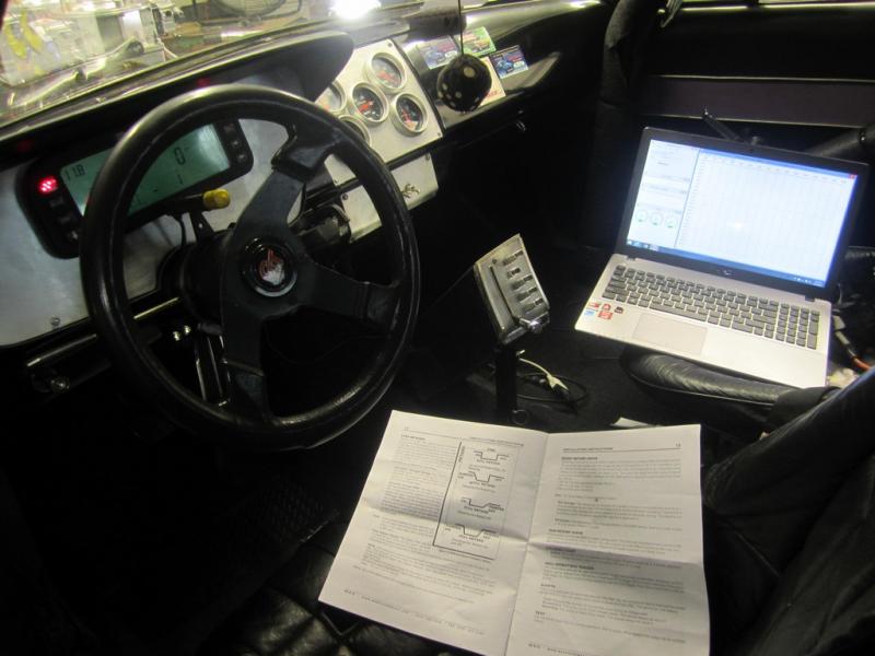

I will NEVER give up my pushbutton shifter!!!!!

Very nice set up. I'd like to do some aftermarket gauges in that speaker panel area. And love the way you did the speedo panel!
And more info on the shifter set up too. Post a couple more pic if you have them. I wana steal it!View attachment 313612
