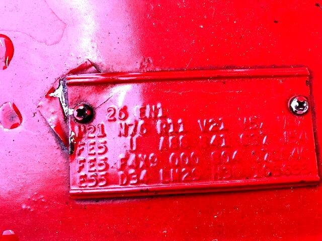

Can anyone tell me what might be going on with this fender tag?Was there another one and it got removed???
A88 - Interior Décor Package - wood grain door panels, rear arm rest w/ ashtray

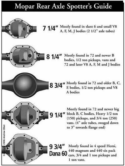

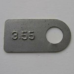

What would be the stock rear end ratio for 1973 dodge dart sport 340?What is the easiest way to tell a 83/4 rear from a 8 1/4 rear end?
look on the center,should have a tag
