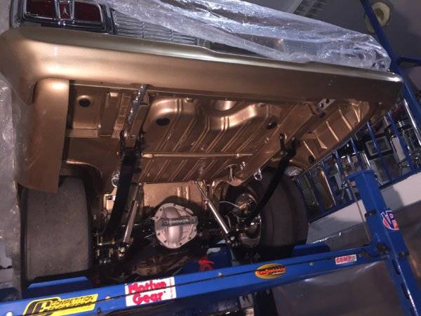

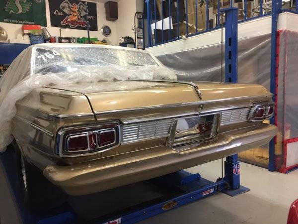

Have been working on taking weight out of my Plymouth during the off season. Part of the weight reduction includes switching to fibreglass bumpers. The rear bumper was ordered from AAR and it showed up last week. A VERY NICE piece that took very little to finish and install. Extremely pleased with it. Check it out guys.
Fit was exactly right, lightweight and sturdy.
Rear bumper is 30 Lbs lighter than the chrome bumper and brackets that came off.
The front bumper was another story but after dozens of hours of work and reconstruction it came out ok. 25 Lbs lighter than the chrome bumper and brackets that came off. Would have saved more weight but it needed lots of work, mat, resin, wood to make something out of it.
Rear bumper is very straight - just the way it came. I'd certainly buy from AAR again in a heartbeat. Will be interesting to hit the scales next season. Expecting to be about 130Lbs lighter next time out.

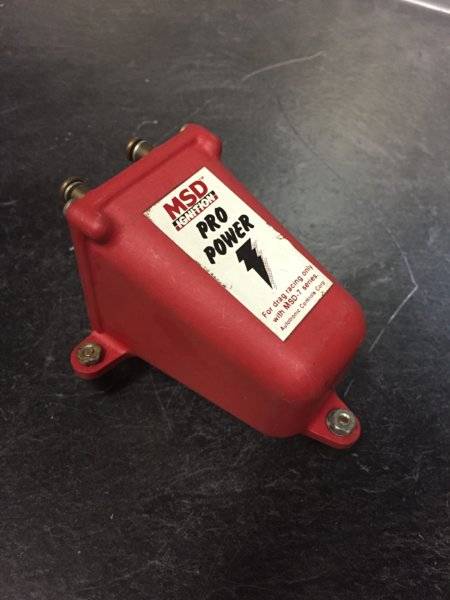

Question. Do you guys know if this MSD Pro Power Coil is compatible with the MSD 6 AL?
