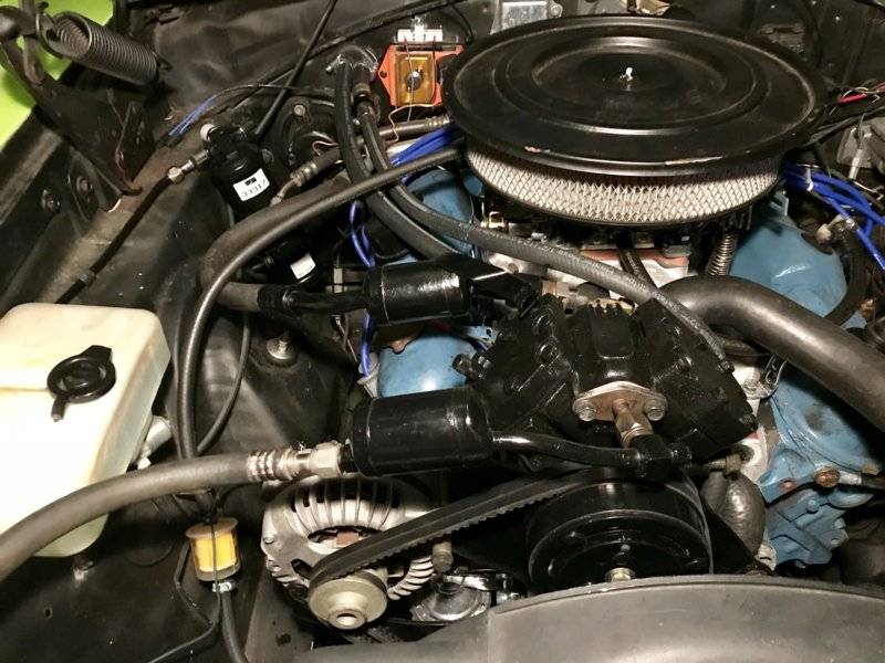

I would say leave it out. If it wasnt in the new compressor then i wouldn't put it in. I know in some other types compressors the plug is used as a mechanical unloader but don't believe this is the case. Just a thought if that came out of the old one maybe somebody forgot to remove it and thats why the compressor is locked up.
