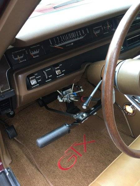

Simpler alternative to cruise control. I bought the hand control unit I installed in my GTX for $500 on Ebay. The design has been around since the '60s, and bolted right in with no modifications to the car. Like the factory A/C, I typically don't use it on the way to a show, but both are nice to have on the return trip.Yes to AC. As I get older I appreciate the creature comforts the new cars have. Cruise on a 4 hour trip would be something else that I would enjoy.

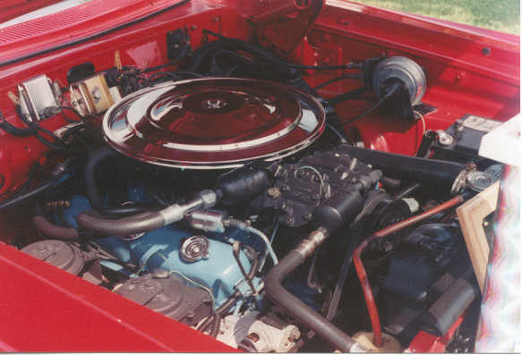

Year One is having a sale on the whole AC system. I think it was around $2450 for my '69 Charger, which was a factory AC car when assembled. AC system was missing when I got it, but the firewall stubs for freon lines are there as are the dash controls. I mention this as the systems they offer are with or without factory air, so watch which one you pick.If you had an option to add air conditioning to a big block car, would you? How much hp would you lose? How is initial investment and maintenance cost (ac unit, pulleys, belts, hoses, charging annually)? And in the end, is it worth it?

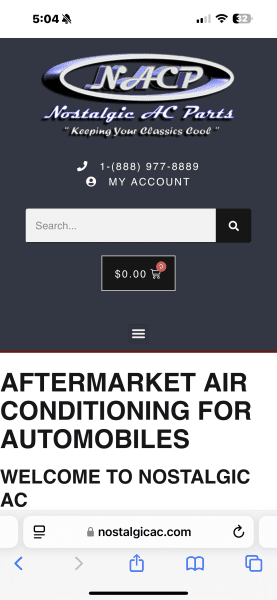

Call Nostalgic Air Parts, they’ll have a bracket for you that should work. The setup uses a modern sander compressor. It was the only place I could find that had one for power steering OR non power steering setups. The eccentric didn’t line up with the pulleys I had so i sourced a shorter one from U.A.C. (Purchased through summit racing). If you decide to try it and have any questions let me know.I am looking for an aftermarket add on unit that would use a much smaller, much more efficient rotary A/C compressor. My '64 Sport Fury had factory air many year ago and that parts that I have are obsolete. the duct work is in the dash and if for not other reason, my wife would really appreciate a cool breeze, especially on a road trip.
