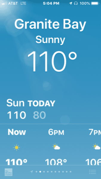

Hotter than this?I live in a very hot climate.
I use just a good 19" factory 7 blade fan and shroud and have never overheated.
