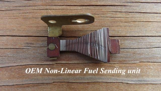

Aftermarket? no. Have your original rebuilt. There's threads here and on FABO about the subject.
Nobody makes a sending unit that reads like an original. Originals were nonlinear and all the new ones are not. If you want it to read correctly, there are places that can rebuild you original. Otherwise, you just have to bend things around to get it to read close enough.

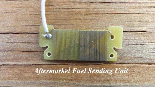

Agreed. Here's where the problem lies. The shape of the sender boards, non linear (original) vs linear (repops)
