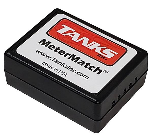

Just get one of these. Simple to install and you can set the low and high side to your liking. I put one in. Empty tank and added 3 gallons. Set the E side so the needle was dead on E. Filled it to the brim and set the full side to one needles width past the F mark.
MeterMatch Fuel Gauge Interface Module
Pnora, I watched the tanksinc video after reading your post. Did you drop your dash to gain acces to your gas gauge wires to install the Meter Match fuel module?
