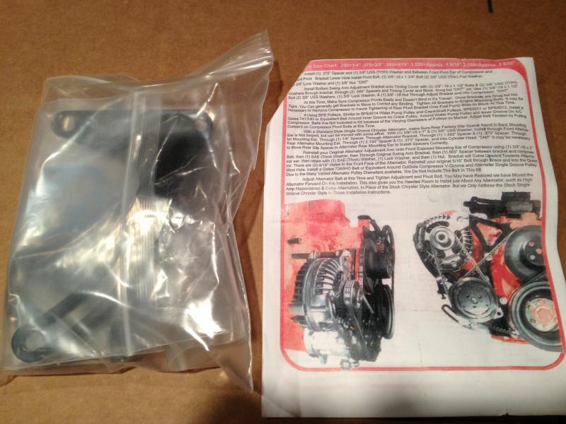

I am adding A/C to my 70 Road Runner. I plan to drive it a lot, and want my wife to actually come with me sometimes. This means the A/C is a must. It is an air grabber car, so I wanted the A/C hidden. The aftermarket has a nice under alternator bracket that makes the A/C very hard to see. It also does not interfere with the air grabber. For me, I would never have wanted to install the huge Chrysler compressor on top of my engine.

See below for a picture of the hidden A/C bracket. A bit hard to see, but hopefully you get the idea.
