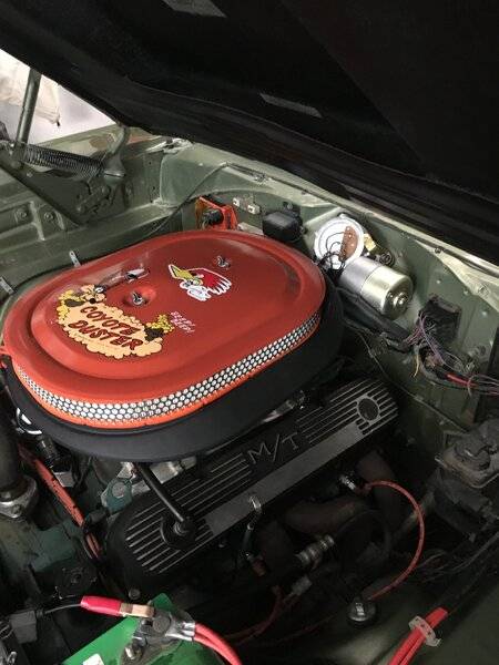

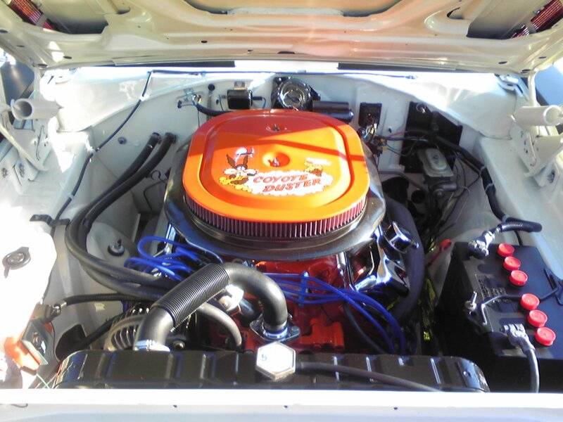

Anyone do a cold air intake setup? Worth it?
Isn,t that a air grabber hood, the intake is already air gap, or are we talking chevy ?
Similar to a ram air setup, routing hose(s) to enclosed air cleaner with air from front or side of the bay...unheated engine bay air. There are aftermarket kits for this or DIY tricks. Have read this can garner a few horses and lower end torque...suppose it could since ram air is well ram air...lol
I did read somewhere that the six pack hood was good for 10 more horse at the end of the quarter
All the aftermarket "cold air intakes" replace the CAI that is supplied by the factory.
