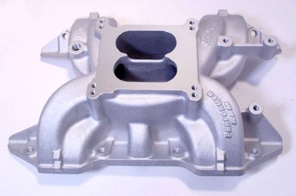

Edelbrock Performer RPM manifold 440

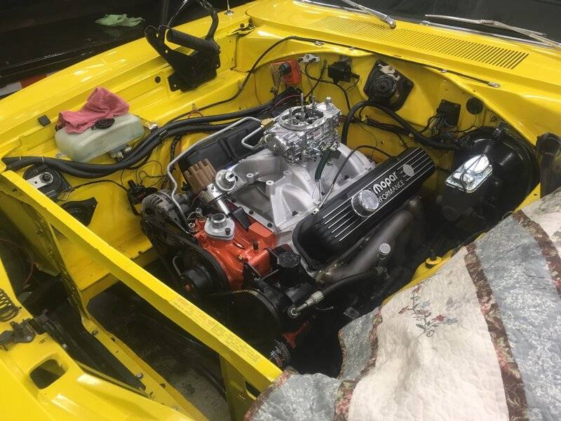

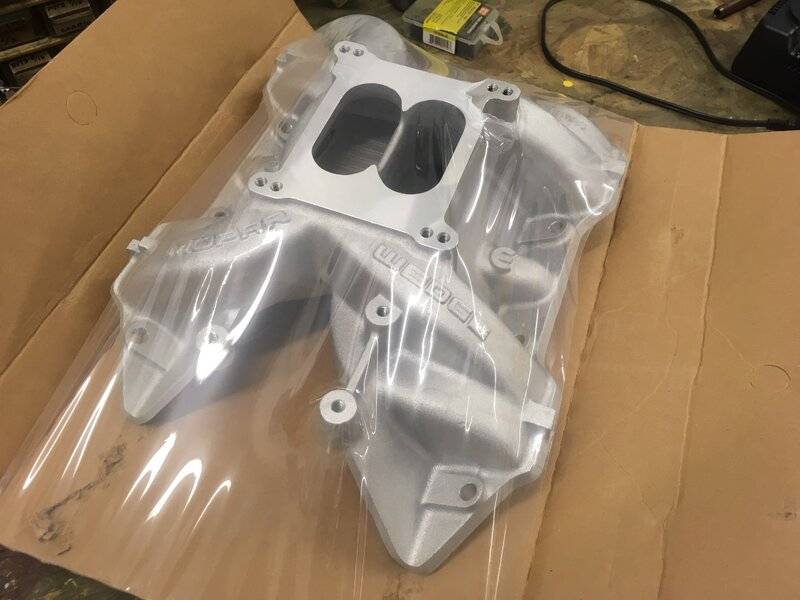

If you want one that has Mopar written on it, they offer the same intake with that. It is a copy of the Edelbrock RPM with the MOPAR WEDGE script on it instead. Few bucks more, but I didn't want edelbrock written on my engine and wanted Mopar instead......I know I am **** so sue me! Hahaha!

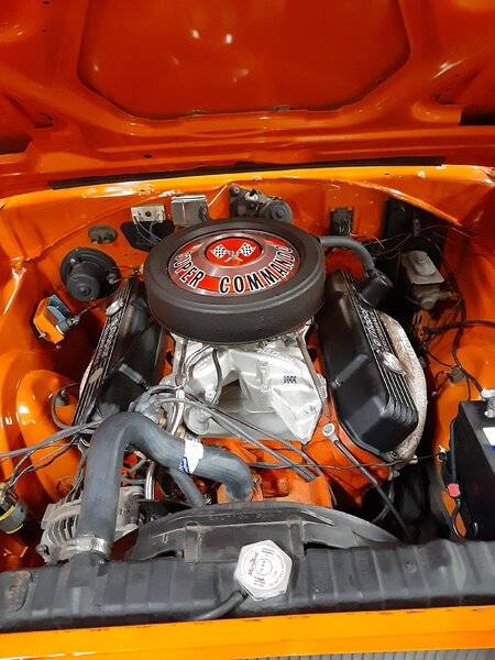

I've got a 72 RR -440 and I had a performer rpm with a holley 3310 and needed a drop base air cleaner base to clear the hood. Other than that it worked very good for me.

I think I would do the same and go with the mopar one. It looks clean.
The RPM is a great manifold, but is almost 2" taller than the cast factory intake. A 1.25" drop air cleaner base will get it to work, unless you have an air grabber hood and ductwork. Then you are stuck with something close to stock height.
Yea I am running the drop base from Mancini Racing. Its on a 68 Charger and clears fine and I hear that's the worst of the hoods to clear are the Chargers 68-70.

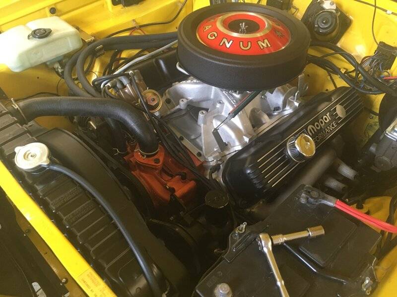

GET THAT WRENCH OFF THE TOP OF THAT BATTERY!
I figured someone would comment sooner! Don't worry no welding between the poles of the battery occured! Just set it there to take the pic....all is good.
