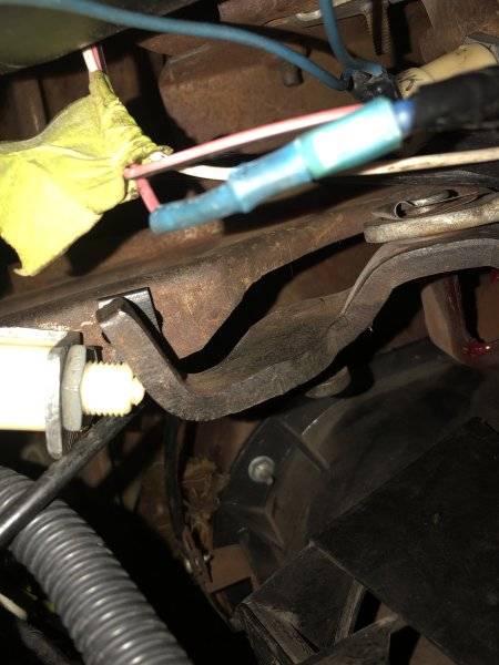

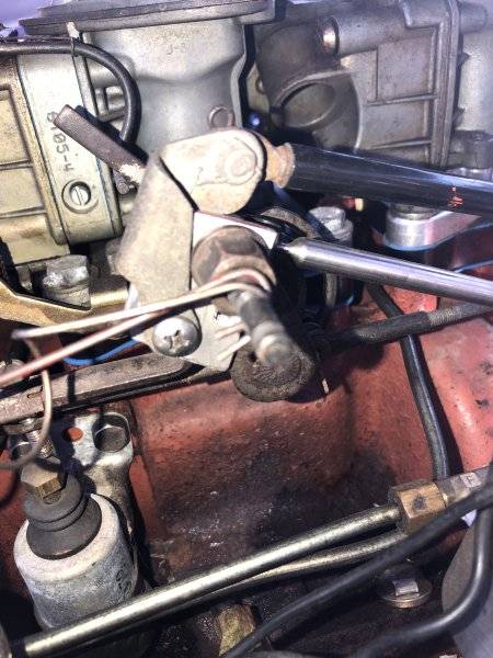

After about 6 yrs, I finally got cruise control installed on my 440 Six Pack 4 speed car. Cruise wasn’t available on any 4 spd or any six pack. It works GREAT using all factory parts except 2 small modifications. I added a 2nd cruise stop light switch on the clutch pedal (wired in series) and a small adapter at the center carburetor to attach the cruise cable.
