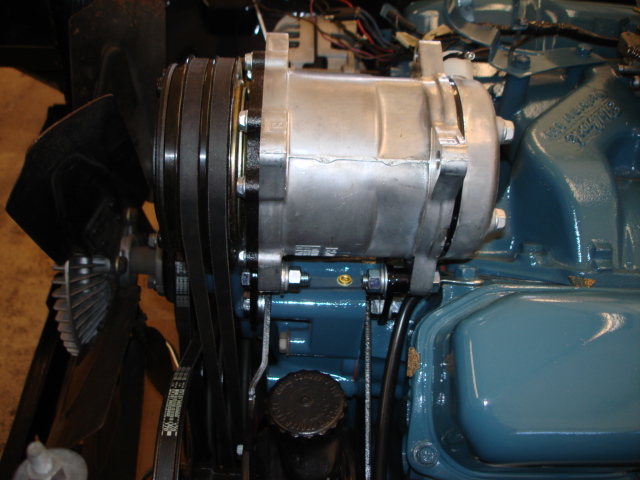

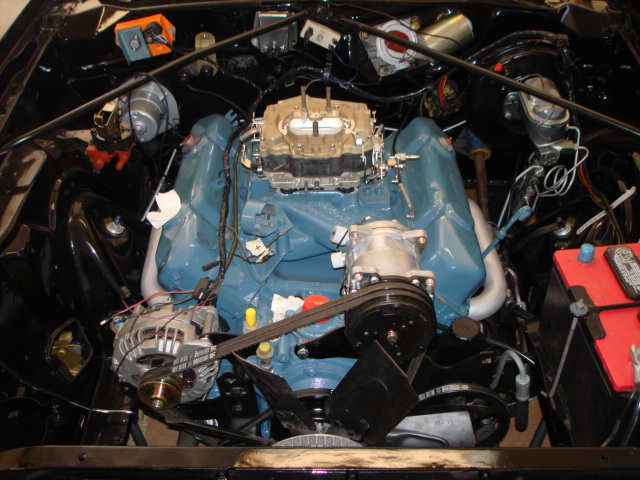

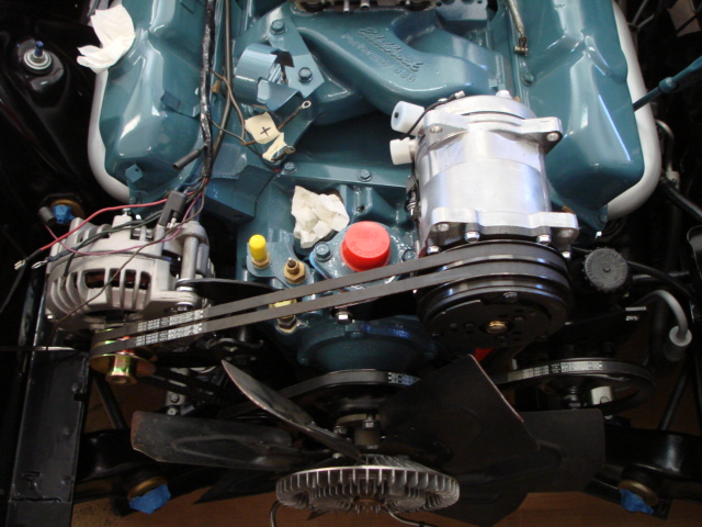

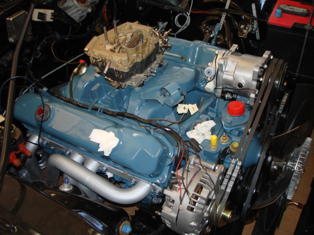

I just purchased a new A/C systems for my factory air 72 SSP. Instead of converting the old system I decided to convert over to a newer style system. I purchased my system through BPE.
http://www.bpeusa.com/
I spoke with both Vintage and Classic but they didn't offer kit for my 72 B-body. I would have had to purchase a universal kit and adapt it as needed. So far the kit from BPE has bolted right on without issues. BPE offers kits for both factory A/C and non-A/C cars.
Below is photo of the compressor installation that I just completed about a week ago.

I bought Vintage Air mostly because I liked their servo motor operated evaporators but went universal because I wanted a clean customized install. I've yet to install it and need to decide on a pulley setup, I like the looks of yours but am having trouble making sense of the belt routing? Is that an idler pulley causing the water pump belt to go to the passenger side? Looks nice, I'll check out that link.
Sorry for the hijacking
Yes that is the idler pulley routing the water pump belt over to the passenger side.
This is the location I'll be shooting for on mine.
Bouchillon also has a mounting bracket for the other side if you want to run a power steering pump. I used it for my car and it fits well. The only down side is you cannot run a factory fuel pump - you have to run an electric fuel pump. That worked fine for me since I was adding fuel injection anyway...
