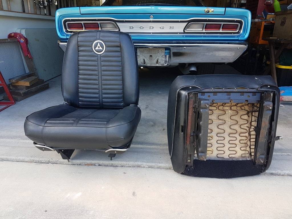

My seats are out of a 64 Dart ( apparently) and they dont have a seat recline/lock lever, So the seats can flop forward. I dint know if thats how they were then or someone has removed the mechanism. Im just wanting to know if anyone else has run into this problem and added a lever mechanism in

Well they dont even lock into place. Im thinking of going to a wreckers and getting a lever mechanism and retro fitting it.
These are the seats
68 was the first year for the seat backs to "lock" into place. I hated my 64's just for that reason, especially if ya got on the brake hard.
