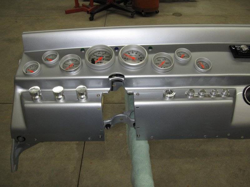

I used a vintage system in my 71 Charger since I was doing a restomod and I used some generic controls to make a panel for my car like what is shown in this pic.

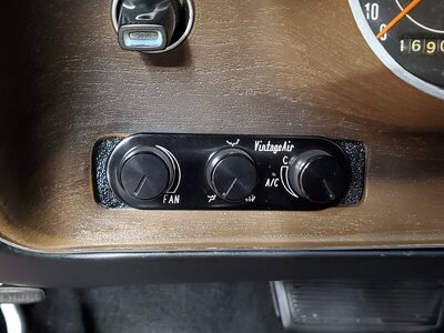

That control setup would look better if you placed a rounded end plate under the VA control to cover the original opening.

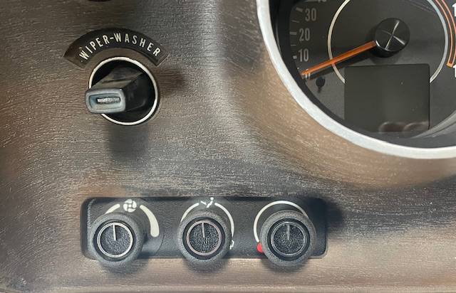

I was happy with the support from Vintage Air. @Kern Dog is a good resource for AC install look for his thread.
I'm surprised neither Classic or Vintage have controls for the 1971 B Body.
