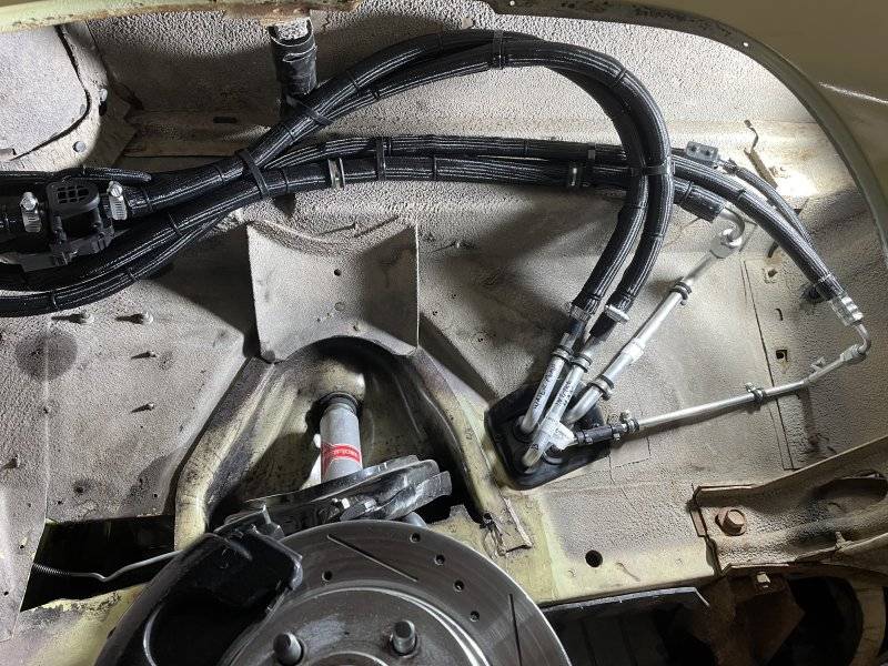

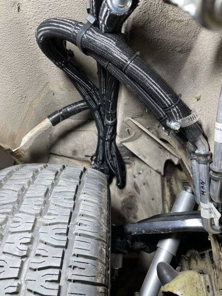

I can’t say too much yet, but I’m in the middle of doing the Vintage Air complete Gen IV kit on my 68 Satellite. I wasn’t a fan of the fender wall routing, but I’m also building a 440 for it later (5-10 yrs down the road. It has a stroked 390 (from the SB 318) and I was hoping it would help with engine bay fitment. I’ve got the hose routing in the pass fender done and loomed and here’s what I’ve got so far. First pic is everything clamped/tied in place. Second is with the wheel on and checking for clearance above/behind the tire. Hope this helps you in some way.
Wow ! That’s a lot going on above the tire . you’ve done a great job with those. But that’s just not what I want for my car. I like to drive it “3 seasons” here, and it’s been in the rain and down some sketchy roads in all the years I’ve had it. I considered using Vintage and making some light tin covers for those hoses, but now I see that’s a lot more than I want to get into. No offense intended at all, your work looks great, but in my opinion that’s a mess. I imagine it has to be there for the entry into the interior and fitting to their unit. again please dont take my comments the wrong way. Thanks very much for posting the pictures.

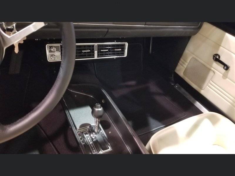

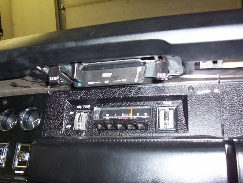

Well, thanks to all that have responded and all the pics and links about adding a/c. I built a cardboard mock up box to see if an under dash unit would fit in my 68. It’s a no go, the tremec 5 speed shifter sits too close to the dash, the unit has no clearance. So more google searching. I really liked how Steve Strope did the yellow Plymouth Scamp, it had a vintage air mark IV style under dash. Of course it was automatic and console. BUT, found out that he ditched the factory heater and put in a small separate heater also from Vintage Air. from what I can tell, the smaller heater allows the under dash a/c to slide back further under the dash. The pic attached is the Plymouth Scamp Strope did. I don’t drive the car in the winter, so a smaller heater may work just fine. I know the oem heater will make you sweat in the winter.
also, both Classic and Vintage use a ECU for their complete replacement units, and my Buddy putting one in his car has yet to get it going, they think the new ECU is bad. I like the appeal of simple, like it might have been in the 60’s-70’s.
Sure...no offense taken. Total there's two 5/8" regular heater hoses and 2 A/C hoses with fittings. Lastly power wires and heater module with wires. Yes...there's a lot and I think I might built a shield for it.....but just to make it look more tidy. Best of luck to you. Just got it all wired and am charging the R134a today. Fingers crossed and then I can wire loom the engine bay and get rid of all the zip ties. I have the American Autowire Classic Update Master wiring kit on it too. Kept the 2 mega fuses on the firewall next to the wiper motor. Best of luck!!
