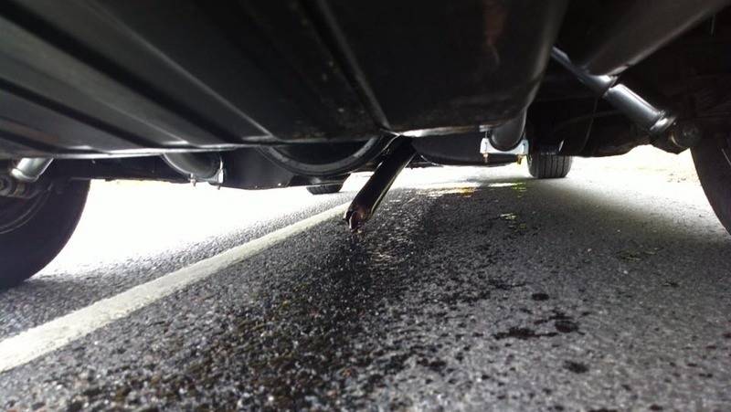

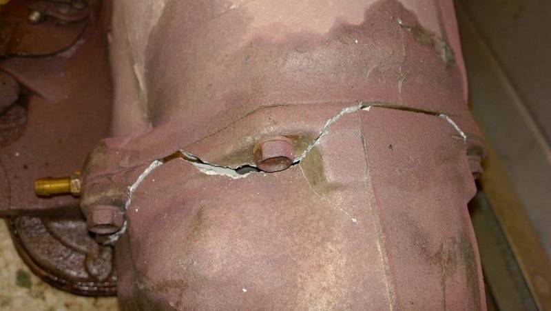

Driving without pinion snubber. + Broken mufflers:
This looks tough enough. Does anybody ride with this?
