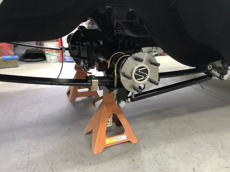

I'm trying out the Caltrac stuff in the spring. I have the split monos, bars, sliders, and Afco DA shocks on Krusty. Supposed to be a killer setup.
There are some cars running split monoleafs and no Caltracs. Jordan Pennington ZL1 camaro in F.A.S.T. is one running mid 9s. I think the caltracs hit to hard on the small tire he would lose traction. He took the cal tracs off...But...he also has really fancy shocks and a longer front spring segment then any mopar.
