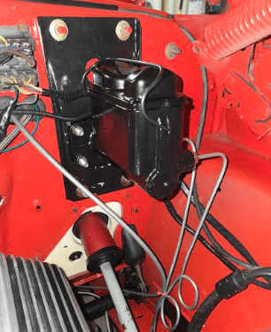

Just installed this in my 65. Removed the " leaking" adjustable valve. No issues so far. I use DOT 5 fluid and a motive power bleeder.
It looks to be powder coated.
