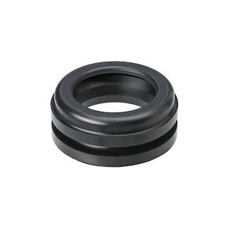

Fuel filler tube? Yes, there is a rubber donut grommet that the tube fits into and it can crack . Or you could be missing the screw that holds the tube to the car.
Link to the grommet...

Grommet goes on the gas tank, fuel filler neck slides into grommet.
Pull the filler neck out to remove the gas cap.

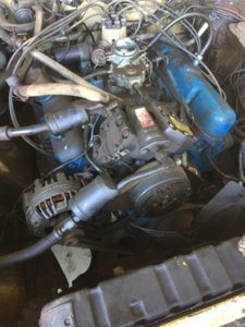

Pic for the basket case:
Welcome. I have owned 3 70 Satellites (all convertibles) with 318's. The engines really are indestructible. Enjoy !!!!!
