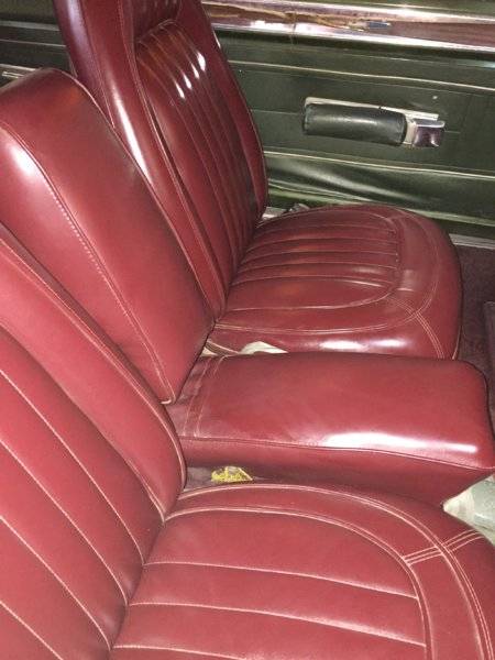

Interior is Christmas like (Red and Green)....Do these look like stock seats to you? I know the interior was originally green, just curious if the stitching indicates originality or a redo. The plastic seat backs are also matching red. Either way they are like new
Is it just me or does this totally not seem like a 14k mile car?????

Its says 14k on the OD but it must be 114k abused miles. The OD numbers all looked straight and I thought that after the OD tripped over the numbers no longer would be straight but I guess thats a myth?

114k seems a lot more like it.....
Still, cool car man!

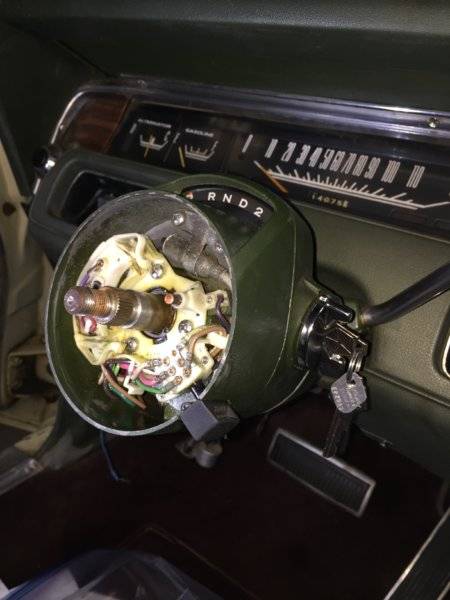

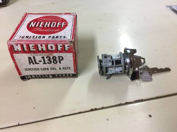

Ok so I replaced the lock cylinder this evening. Was a piece of cake compared to the GM tilt telescopic on the 71 Vette I restored! I purchased a really cool lock >> I love what you can still get these days! Made in Illinois (on Lawrence Ave) too! Now I have to see why Bubba disconnected the linkage to the trans. I bet it was because the lock was FUBAR! What do you think?

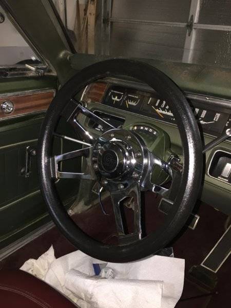

Well the old wheel was shot and I do like to keep as much as possible stock but got a great deal on this baby. Waiting for the install kit....#tities

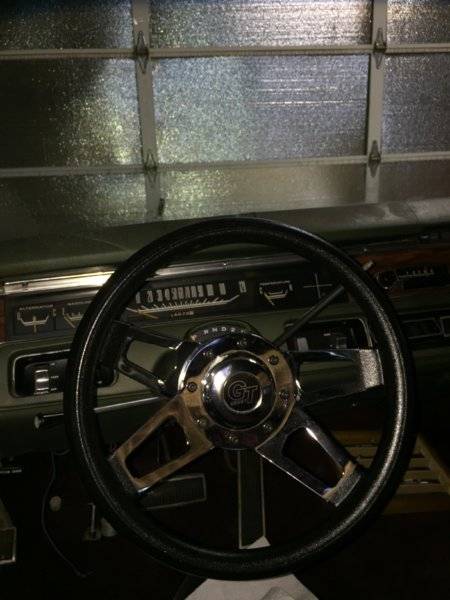

The shift linkages have all been sorted out, I took all the linkages off and wire brushed them clean to the bare metal. Replaced all the bushings. The steering column is mounted and secured and the new Grant steering wheel has been mounted! Feels great and is very functional. So far that's all squared away.

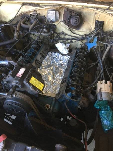

Ok so I tried to clamp off the broken water pump heater nipple (can I say nipple?) and it just crumbled. The water pump is shot! I did not want to have to replace it because I have to mess with the AC but now I really have no choice. The material and age of the pump is very poor like VERY poor. Here is a picture of where I am at now!

You'll be happier in the end with the new water pump....just getrdone!

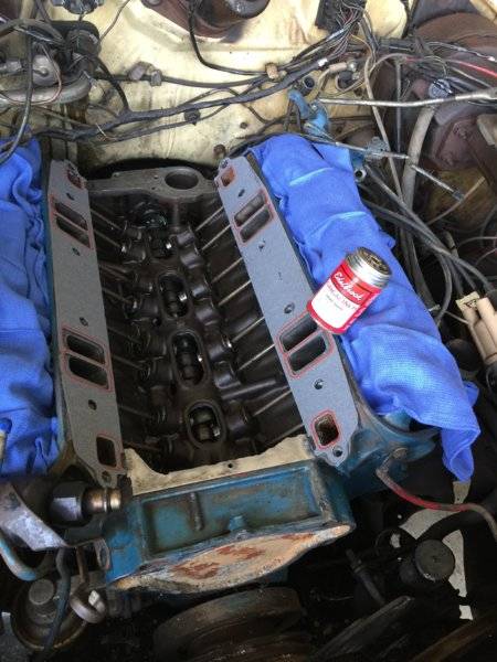

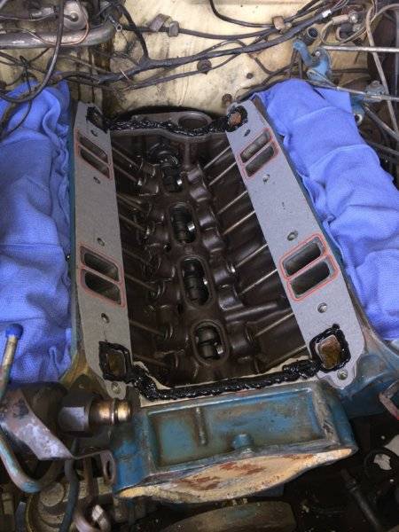

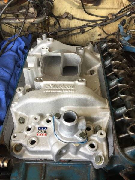

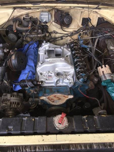

Got all the accessories off and manifold installed!
Before you reinstall everything, clean and paint it.....best time while it's all apart....you be super glad you did!!!

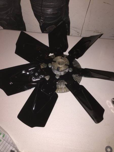

Hi Jeff, Paint what exactly? I painted the fan and water pump pully. I dont plan on painting the water pump or manifold as the aluminum for now looks to good. Are you talking anout the block? Heck at this point I have no idea if she will fire up.
Paint the heads, block, and various brackets etc....anything and everything you can.....
Easier now than when it's all assembled. ...lots of people paint engines while it's still in the car...you won't get every inch, but you can get 99% of what people will see when you open the hood.
