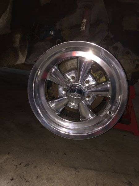

Ok what is the first thing I purchased for the car? You guessed it what I did not have money for back in the seventies lol These are the sold cast aluminum non rusting Cragars 15x7 for the front and 15x8 for the back!

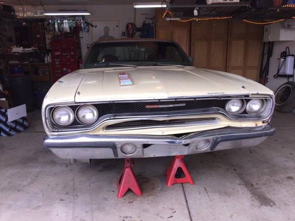

Here she is,,,,,,, She had a minor impact not sure how the bumper got like that. The plastic is OK but I will need to push out the right headlight support to get the lights back in line. I wonder if the bumper could be repaired for a reasonable amount....

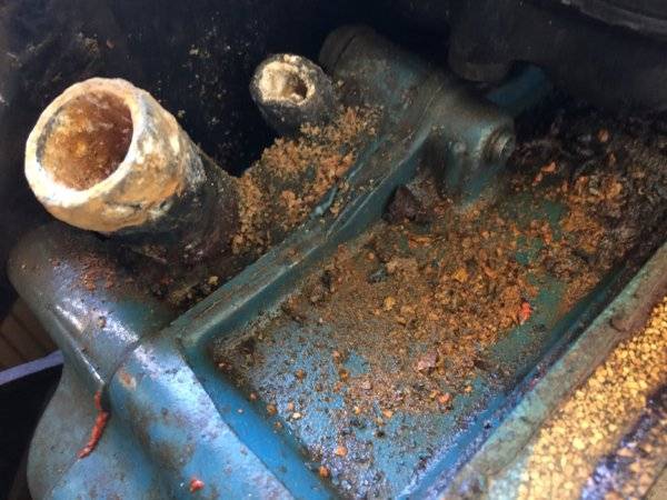

Yes I was expecting more surprises on that front. I did however find this gem of an issue on the water pump. I am not planning on hooking up the heater hoses since I am in Phoenix. I might later after I change the water pump. For now I can going to clean it out and see if I can tap it and plug it. wish me luck on that one lol....

New water pump is $25 plus the hose fittings. Easy fix. Even in Yuma during the winter I use the heat at night and early mornings.

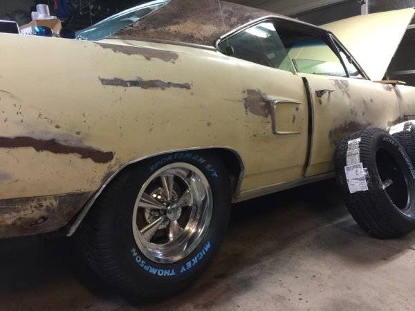

A rear (not rare) view. Bumper needs a tweak and the old body work was done by Bubba again. Gonna have to fix that too after I get the car running. Here in AZ its very strange.

Its amazing what new Cragars can do to a pile of junk!
