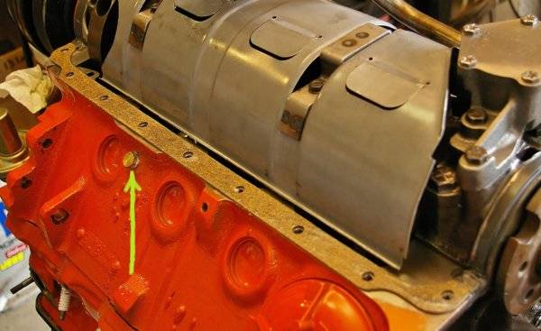

I'm guessing you didn't drain the block (plug on each side).
No I just vacuumed out the fluid see on top of the pistons in the cylinders. I will hunt for those drain plugs.
