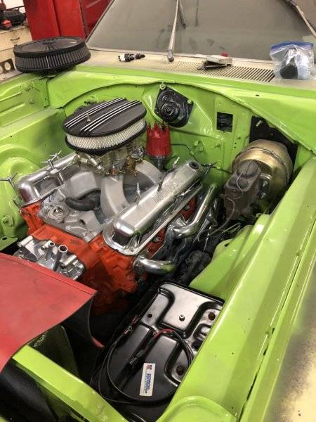

Ok after much ado here is where I am at. This is a built 340 with high flow water pump and 60gph fuel pump and a Holly Double Pumper. Messing around with air cleaners (more on that later). The 904 has also been built with steel drums and shift kit and other goodies.
The only issue I have is with the MSD dizzy being too high interfering with the wiper motor. I just leaned that there are 3 MSD dizzies with differing shaft length. Looks like I need the 8 inch. Going to run an MSD 6AL with this.
Guess you can tell what color the car will be as well lol..
Very nice. Maybe pep boys will have a air cleaner that will work for you?
Hiya Bill! The story behind the air cleaners in the picture is an old interesting one. The one on the car is one I got for the 318. Not a performance air cleaner really but it matched my black valve covers. However the one on the fender I used on my corvette for synonym tuning. That air cleaner flowed better than no air cleaner and was worth 29HP over the 14x4 air cleaner I was running. I thought I would try it but the drop base didn’t clear the Hlley.

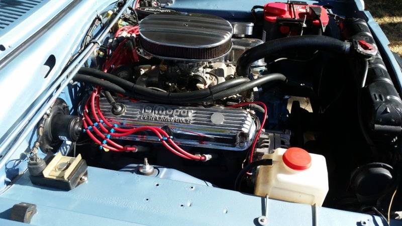

Nice looking engine bay. I have the same air cleaner in raw unpainted form on our 65 Barracuda. I also have a Satellite, but a 68. From Az originally, Bisbee to be exact. Glad things are moving along for ya and great to see all the fellowship and help this forum has to offer! Read the entire thread tonight.
