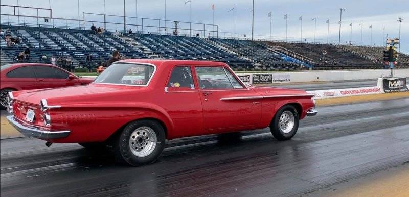

13.38 @102mph Track was well prepped, Street Outlaws were also there on Sunday. No spin whatsoever, 1.89 60 foot, leaving @5800rpm side stepping the clutch. Deadhooking the car but not enough power to get off the line.
Sure was fun to go down the track again though.
This clutching and shifting is way different, then using a delay box with Glide and a transbrake...lol
13.38 @102 is real good ET for that mph.
