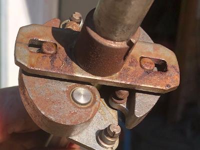

The mechanical advance curve can be way too long in some distributors. In these cases, when you set the timing at idle to say...20 degrees, the mechanical timing adds another 24-28 degrees leaving you with 44-48 degrees at say...3000 rpms. That is way too much timing for today's fuel. Even with 110 octane, the timing is more than that engine would want or need.
The fix for a distributor with a l o n g advance curve is to disassemble the distributor and shorten the slots that allow the long curve.
There are threads here and elsewhere that can explain it in detail. In short, the horizontal slots get welded up a small amount to limit the travel of the advance mechanism. There may be a formula as to how much to weld up but I've just welded up a little more than needed, then file it back open to get the advance to approximately half of stock.
This distributor in these pictures allows 18 degrees at idle and 32 degrees fully advanced. The engine can take more than that if you want to set it to 20 at idle and 34 total.
Just an example.....Many Mopar V8s run strongest at 33 to 35 degrees total timing. Vacuum advance is not factored into that number, this is strictly initial at idle along with the mechanical advance.

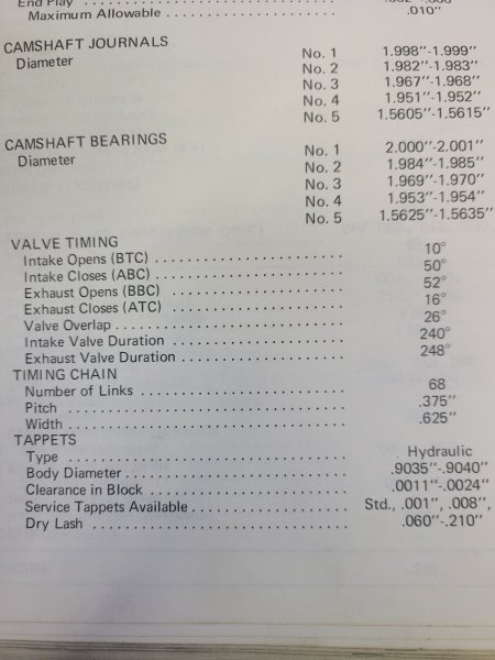

One other "simple" question. I measured our cam using a dial indicator, and took measurements at .050" valve lift. The 1969 Dodge factory manual lists OEM cam duration and valve timing, but does not define the reference frame. Anyone know for sure if the numbers in the manual are absolute, or .050" valve lift, or something else...?

Thanks for taking the time to look at my problems. Your response highlights a point of confusion. I originally measured duration at .050" cam (lifter) lift. Then I was told by my machinist that standard is to measure at .050" valve lift, so I went back and re-measured. My measured duration at .050" cam/lobe lift is 223/245. Anyone know for sure what the "standard" is, and equally important, can anyone confirm the basis for the published cam specs in the OEM Manual?
