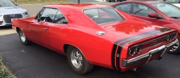

Hi All,
I recently purchased a original panel 68 Charger. I am the 4th owner. The Charger is a matching numbers stock 318 car with auto trans.. I am planning to keep it a regular use vehicle. And as it is all stock... would love to hear what things fellow members recommend I do to it to enhance performance without changing its originality. The car has 110000/miles on it. It is not a rebuilt engine. The suspension is also stock with brakes. The radio doesn't work. Its missing the antennae. Small repairs are needed like all the rubber seals need replacement.
So any advice will be appreciated.

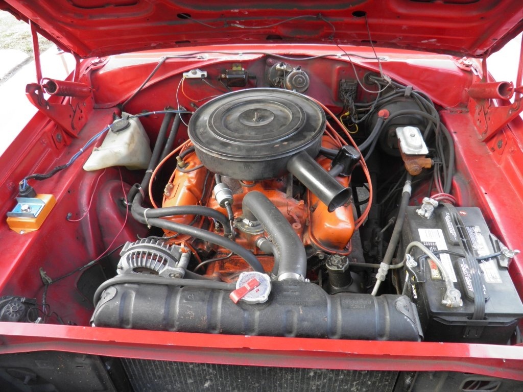

I see from the pics someone has already converted it to electronic ignition so you're 1 up there, I absolutely agree with a disc brake conversion for the front, SSBC makes a very nice kit if you're willing to drop the $ on it, also I agree with the suspension rebuild, i.e. service items, etc. I'm looking at a Polygraphite kit from P.S.T.,as well as Hotchkis or ADDCO sway bars for mine as turning seems to be a nearly 45 degree adventure lol
I will add that the vacuum operated headlight doors on those cars are problematic, alot of guys I know have converted/retrofitted to electric motors from a pontiac fiero wired into the headlight circuit.
Food for thought...

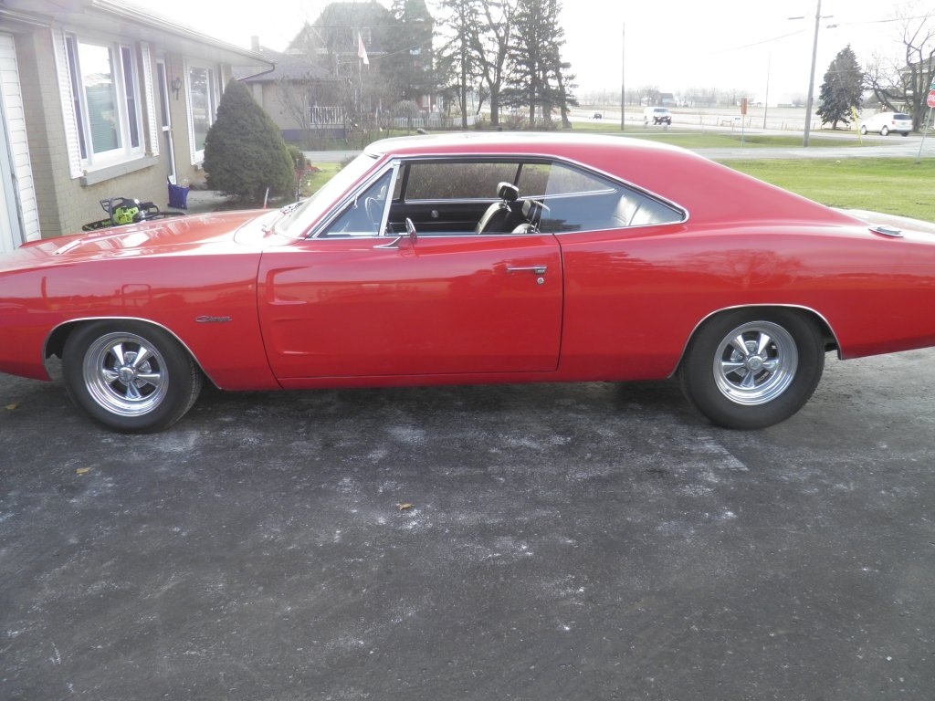

Cool 68, if you'd be closer I think I'd try to make a deal on the old school Cragars.

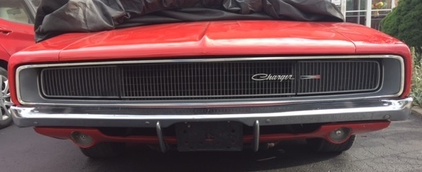

I wonder why the Charger scrip's are on the front fender, and not on the sail panel, that's different?
Get yourself another ECU box, (that ORANGE thing on the right fender well), get the chrome Mopar Performance one put it on and throw the Orange box in the trunk for a spare. Or keep the Orange hooked up and put the Chrome in the trunk.
Get a fire extinguisher and put behind the passenger seat or somewhere, your choice, it's a 48 year old car.
Edit: Missing the antenna, maybe it's stuck somewhere in the car, I see a black car cover, people remove the antenna when covering their car. Did the PO tell you the antenna was missing? Check the cracks where the rear quarters meet the trunk floor in the trunk.
