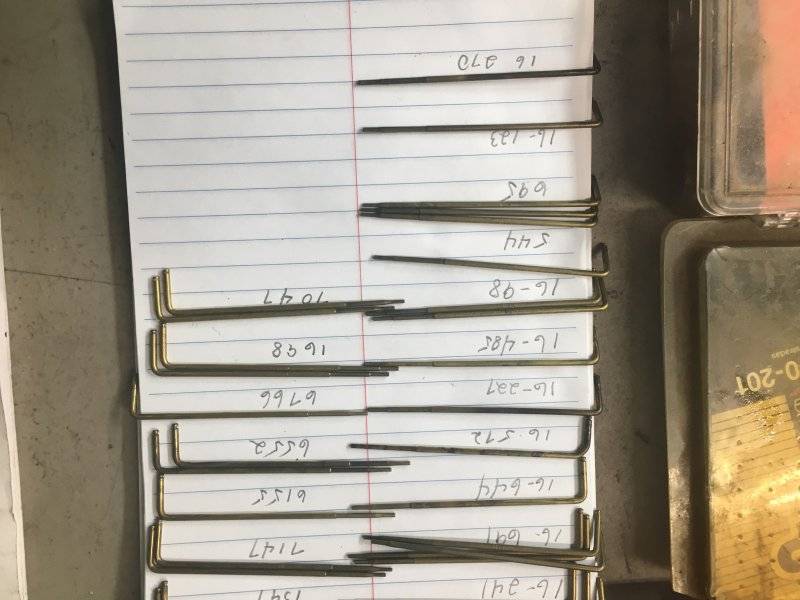

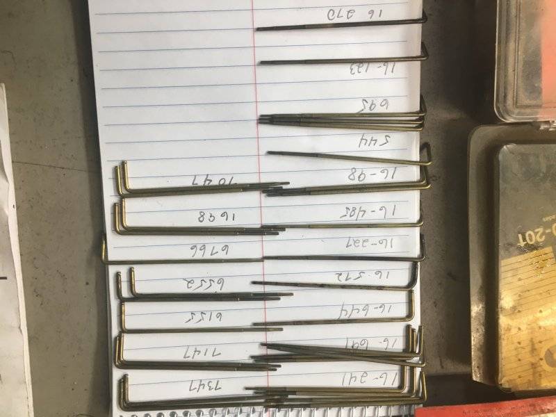

Looking for 2 of each, AFB metering rods
16-136
16-440
alternate choices 16-21 or 16-22
Dan
I buy my metering rods from Allstate carb EDELBROCK AFB METERING RODS - Allstate Carburetor
I don't know the part numbers you list, I go by and so does Allstate the diameters of the steps. I think Allstate sells all the sizes still made. I know some sizes are no longer made because I have some laying around in my carb box.
These in particular rods were for hemi carbs 4139s and 4140s. These were just for these once they went obsolete that was it. I really don't expect to find them but you never know.
I needed to match them all up anyways. If you can use any let me know. I think many of the 16-*** are a 3 step rod, the 4 numbered ones are self explanatory. The 3 digit ones IDK. Now my eyes hurt and I am going to bed.
