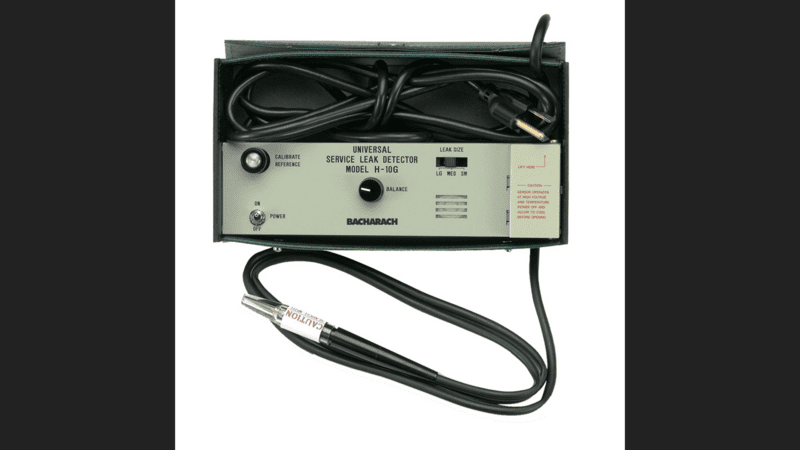

Been finding leaks no one else could for over 30 years, the H10 is the best, wouldn’t use any other.

Been finding leaks no one else could for over 30 years, the H10 is the best, wouldn’t use any other. View attachment 1134715
I used to own 1 of those 20 years ago or so. Worked great for a few years but then started having issues with it. Was sent in for repair twice before I gave up on it. Seems like none of them are reliable for more than a few years, or maybe that is just my luck....
The one I bought 30 years ago still works great. I send it in ever 4-5 years to be calibrated. Of course I had to buy new ones for the new refrigerant and a battery one for when there’s no outlet. Only time I’ve had trouble is when I sucked up water, but I guess that’s kinda my fault.
