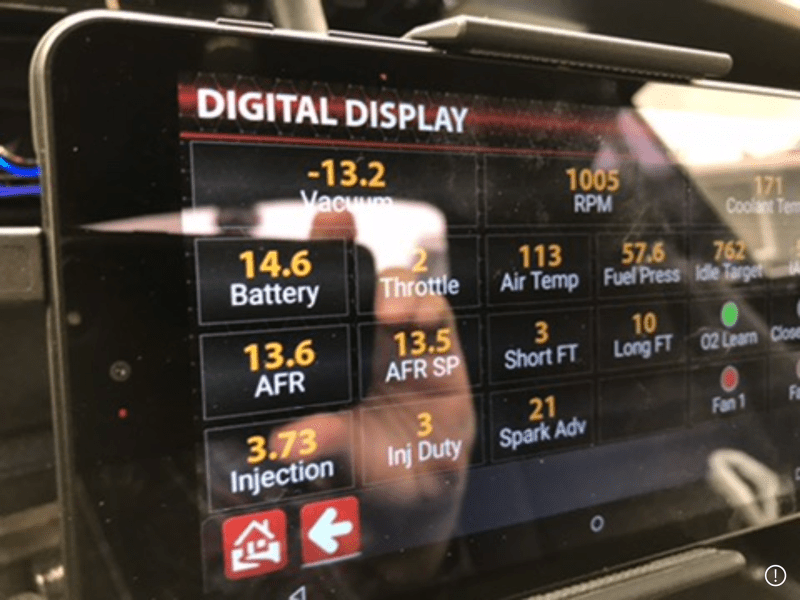

What should it be at idle? I am ignorant, but just on this I think. This just off idle. Idle is 750.
That is about where I usually sit at idle on start up. But then it went super fat then super lean it was weird. I get off work in a couple hours I’ll get the TIC out and see if all the cylinders are doing their jobs and then if I have a leak. And what I’m sitting at.

coolant temp is too cold. fuel is collecting in the intake and burning off...195 thermostat needed
If referring to the pic, car was not fully warmed up. 180 Stat usually runs 190ish. I’m here to learn.
