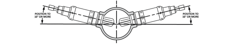

"Mounting the oxygen sensor in the correct location is vital for proper functioning. Proper placement of the sensor should ideally be between six to eight inches after the merge in your header collector, with at least 18 to 24 inches of exhaust pipe after the sensor. That extra length of pipe is to keep atmospheric reversion from allowing ambient outside oxygen to work its way back into the pipe and give you false readings.
It’s important to install the oxygen sensor at an upward angle so condensation doesn’t collect in it. The sensor should be installed at least ten degrees upward from horizontal. Doing so prevents incorrect readings or damage to the sensor caused by moisture that naturally finds its way into the exhaust system.
Mounting oxygen sensors at an angle keeps condensation from collecting on them. They should mounted at an upward angle of 10 degrees or more from level."
