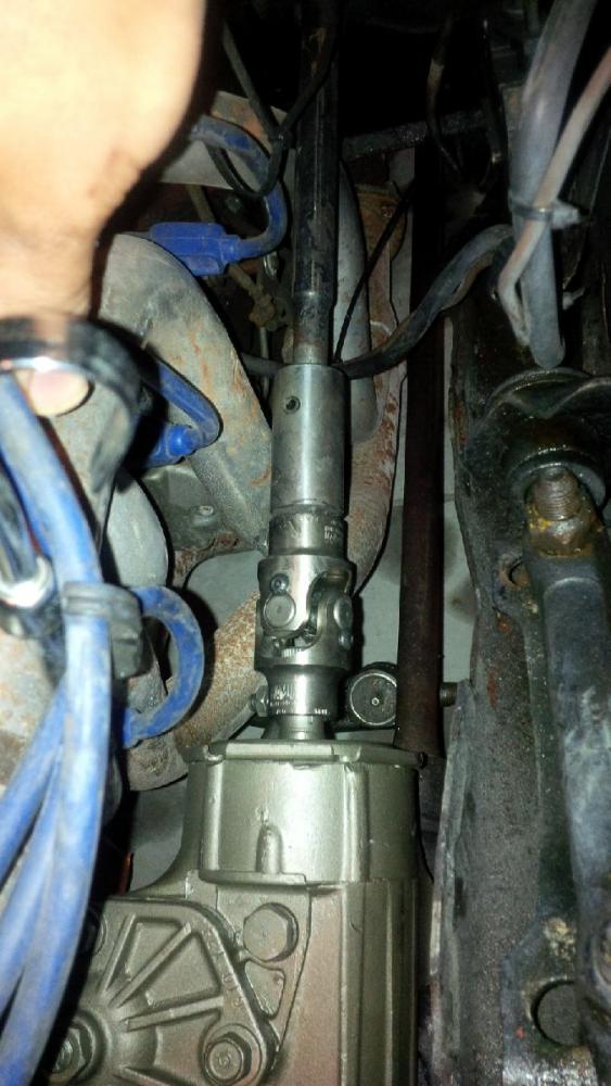

We installed on my e-body column. It was out of the car, and still took 2 of us to install. I needed to touch up a couple of marks, no matter how careful we were. Now that it's on....it's very secure.
I removed mine and replaced it with an adapter from Flaming River. I had to cut the adapter shaft almost to the socket to make it fit since my steering shaft was very long.

I bought 3 of those spring clamps....have one installed on one of my 66 Chargers....got the other 66 and the Daytona to do next....was kinda hard doing it in the car, but took me about 15 minutes to get it in there
You have to just tap it down with a hammer... tight quarters. but it taps in place pretty good
although It did a pretty good job of scarring up my arms. :evil6:
