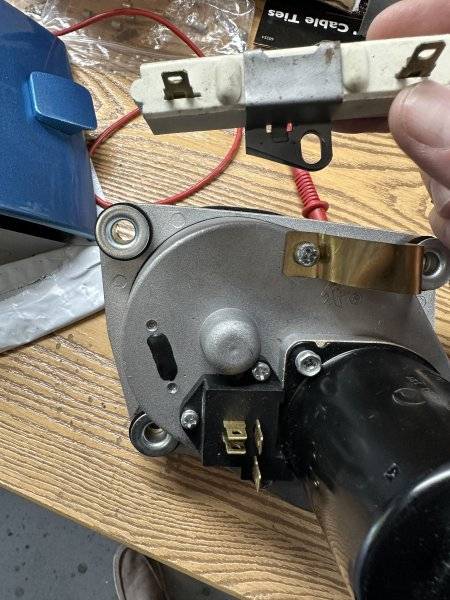

Some months back I ordered a new two speed wiper motor, the illustration looking identical to the original, but what arrived was an after market. There is no screw hole for the ballast resistor so I used the same one as the grounding strap, putting the resistor to the top of the motor, only place it would fit and still have room. It appears that the hood will hit it when closed, very close.
Any thoughts on where this goes? I followed the instructions for bench testing it on high, low, and park so the resistor is needed as far as I can tell. Illustration that came with the motor has it between the ground step and motor housing, but I do not see a way to mount it.
Anyone experienced this and have a suggestion?
If you are not concerned with it being original looking, I would just screw it to the firewall....
Not as illustrated... I'd be after my money back. I'm sure that many here have a working 2 speed kicking around if you post a wtbuy.
How many 66 /6 2dr sedans came with factory AC, auto, and variable wipers? I'm thinking not many....
Yeah got mixed feelings on that, too long ago to return and that's on me. Should have done that before. I may just buy another, original type and sell this one...
yeah I should have, waited too long now tho. I'll probably just source another oem style since the car is all matching numbers, etc. and I am keeping it mostly original...
