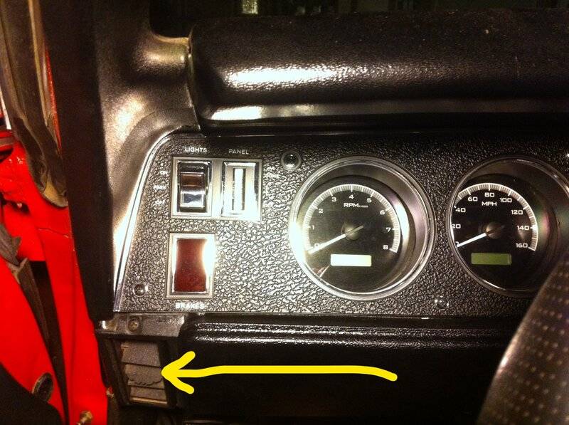

I think the Charger dash is the same. I used Vintage Air in mine with the factory vents on tha passenger side and an aftermarket on the drivers side. Unless you know what you're looking at you would not know it.

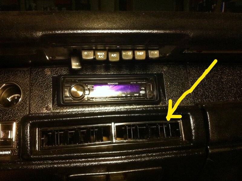

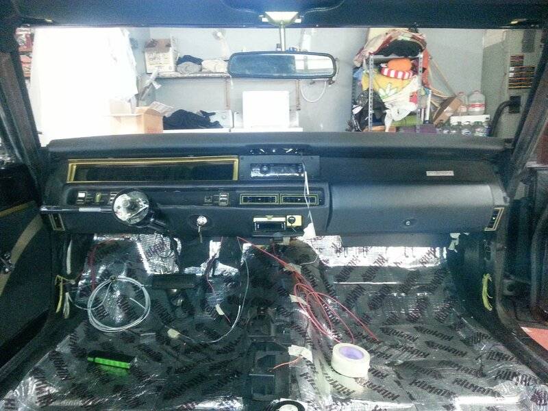

i to cut the dash and installed the factory vents . and i installed the a/c compressor on the right lower and the lines cut to fit and u-bend a/c line from summit. all my a/c lines are on the right side
