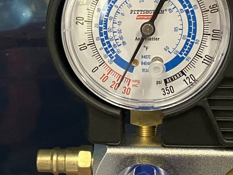

Here we are almost 20 minutes in and it stuck at 22”. I got curious…
I had this vacuum gauge for testing car manifold vacuum levels.
Jugging the hose end while taking pictures…
Look closely.

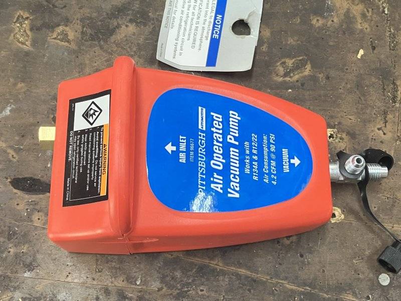

Yeah. It maxes out barely over 20”. This pump is essentially worthless. New ones are $100. I don’t feel like spending that much. Harbor Freight does have a simpler one powered by pressurized air for a fraction of the price. I’m going to try that.
I called the guy at Classic Auto Air to get the spec. For my own car. I needed 24oz of R134 so I bought two 12 oz cans and this:
I set the 134 cans aside for my car. Regarding the pump, My expectations are low.
It MET my expectations!
It pissed air and didn’t do anything but make noise. No pressure, no vacuum
THANKS china….

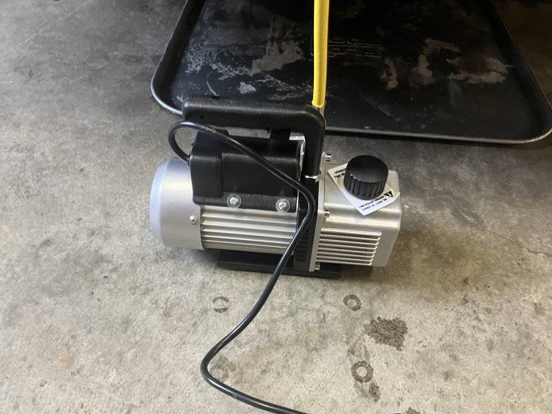

I tried a new vacuum pump that I got from Auto Zone.
It shot up to 30” within 2 minutes.
I shut off the valve and pump. Within a few minutes….
Not great. It does still have a leak. I’m going to go over the various connections and try again.
I did find 3 fittings that were not as tight as they should be. I rechecked and the pressure still drops. I looked everywhere, even under the dash. It doesn't dump pressure as fast as it did the first time I took the car to the shop so the leak isn't as bad. I had a hard enough time finding a big leak. A smaller leak is out of my league so I'll let the shop take it from here.
