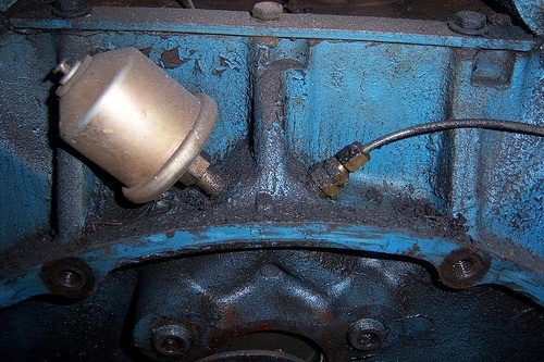

1/8" npt - all the gauges come with everything you need (except for the copper capillary tube). For big blocks, look at the top / back of the motor just forward of the bellhousing. You'll see 2 spots to tap into the oil galley - perfect for the idiot light and the mechanical gauge. Maybe the same for small block, but not sure.
There's TWO? Great, didn't realize that.
Yes, I know where the one existing sending unit is, but I had no idea there was a second - I had already figured on using a tee to retain my idiot light.

Yep! Not often that things work out in our favor like that.
