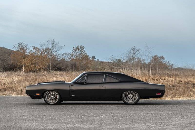

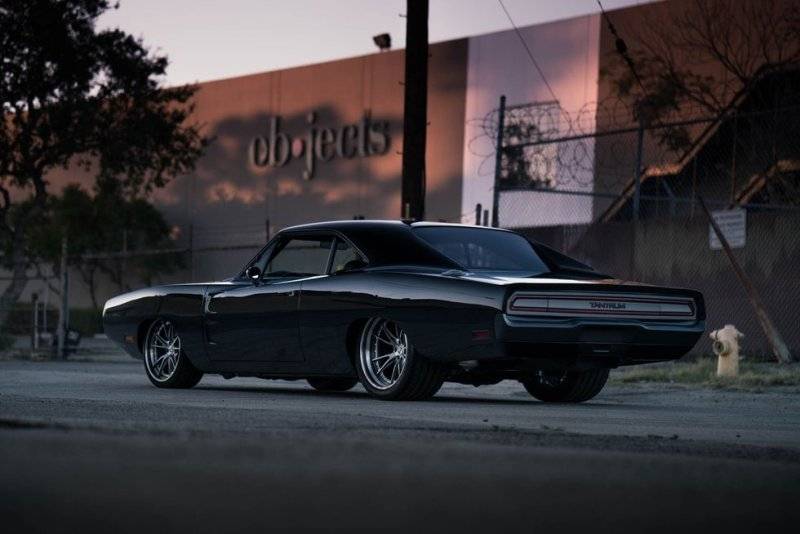

Even companies like SpeedKore that build carbon fiber bodied cars, to build cars like these:
They had to obtain inner structure pieces for the roof structure.

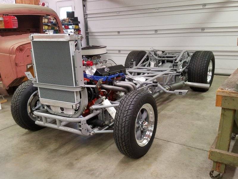

You could go as far as
building a rolling chassis
(as I did), and adapt or
fabricate sheetmetal to
fit.
