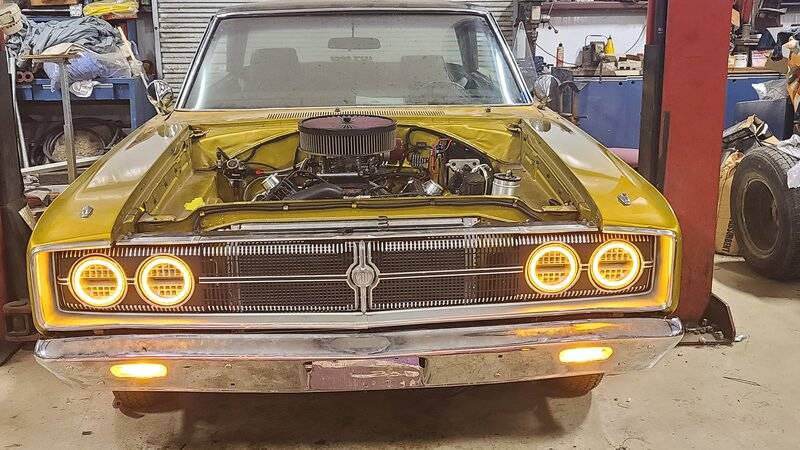

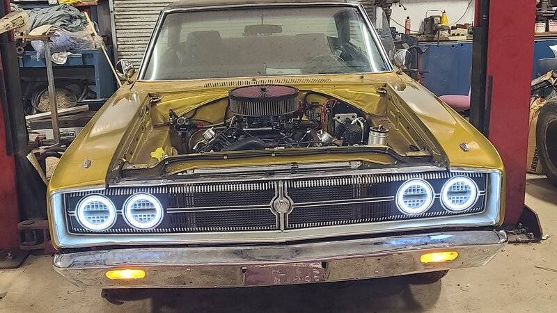

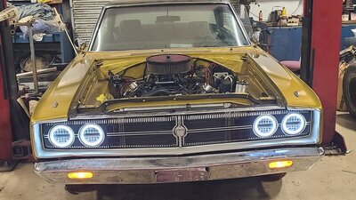

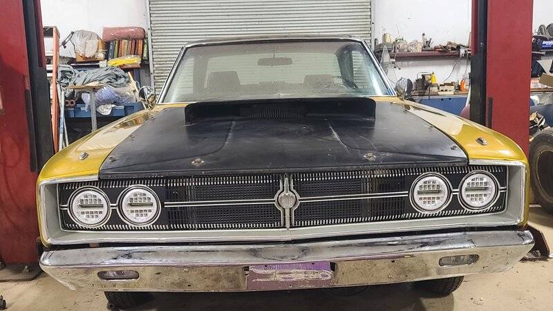

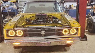

Those lights look great! I've been looking at LED's for my 71 rebuild. All the Halo headlights I've seen require trimming the buckets to fit.
Did you have any major surgery to get them to fit and which ones did you use?
Ya it required me to trim out most of the back of the buckets to clear the heat sinks.
But I have several sets and will never make it a day one so I didnt care.
The pic of the the halos orange was just a perfectly time while the flashers were on. Everyone should be able to see those...
