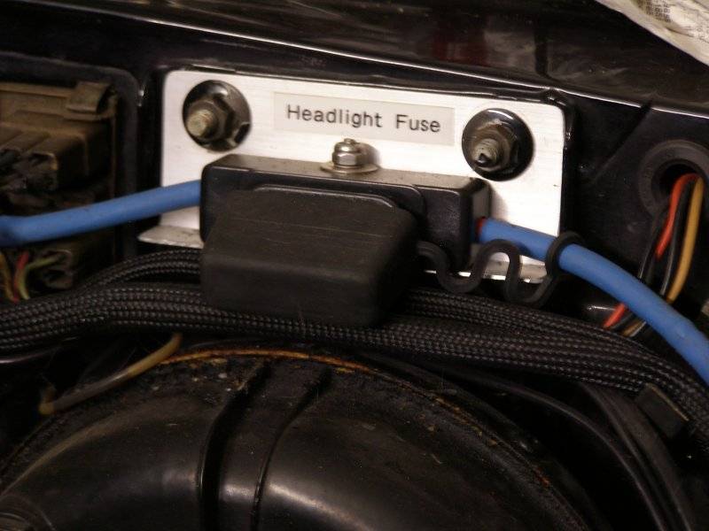

I also installed a relay kit, and felt uncomfortable running such a high current power lead unfused to the front of the likely to be damaged area even in a minor front end fender bender. So I fused it.
Typically, I changed course mid project and converted to lower amperage LEDS. :BangHead:

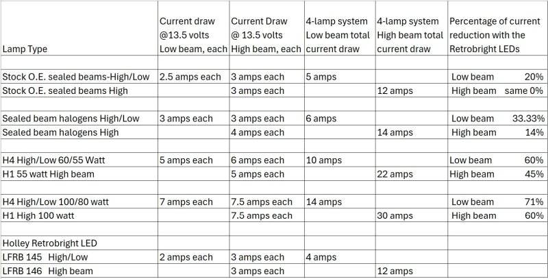

For headlight current comparison, prefer my own measurements over the “published” current draw specifications for various lamp types. Some are quite a bit off the published numbers.
