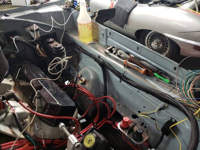

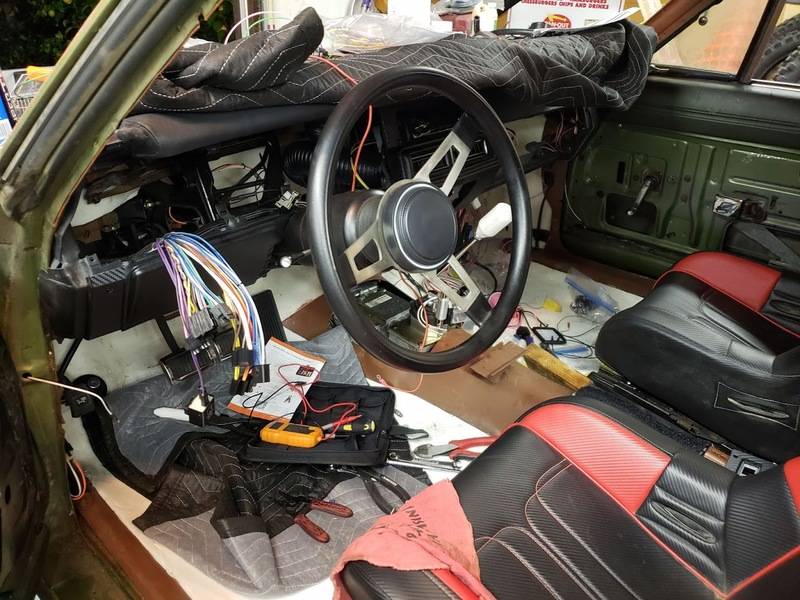

The Quick answer no.. Other then finding out my switches are bad.. it is set-up for the 3 speed wiper and easy to fix for the 2 spd. No wiring for headlight motor, but easy fix..

You have to add a second wire to the Yellow wire at the Headlight switch. Normally this just runs down to the Dimmer switch, but add a second wire and run it out the bulkhead connector for some other un-used wire and to a relay for the motor.

If you look at my pictures, the yellow wire shows up twice. In the Dash picture, the Headlight switch connector is hanging down and you can see the 2 yellow wires coming out of it, (American Autowire sends it with only 1)(1 goes to the dimmer, the other to the headlight motor relay) The Engine compartment picture show the yellow wire loose above the relay.
