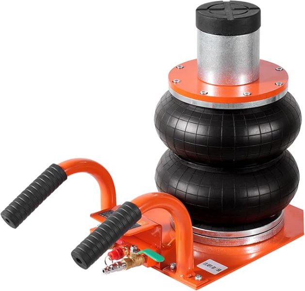

I just saw this air bag jack listed on Amazon as a black Friday deal. I have a 4 post lift with a jacking tray, and I have a small bottle jack I use, which is a bit of a PIA.
Has anyone used one of these? For $100 it seems like a good deal.
I bought that exact one for the same purpose as you. It works fine BUT if you jack the car in the middle - like on the diff for example - it will sway to either side. Ideally you should jack one side and use axle stands for support.
It lifted the rear of the car effortlessly with on 40 psi. It'll go up like a rocket with 100 psi.
I do recommend this item - just use it with a bit of common sense and an equal amount of caution.

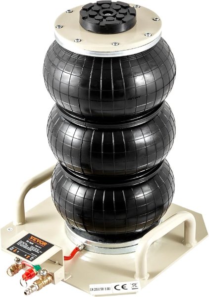

Thanks man. I was looking at a similar one when I bought the lift, but they wanted $600.00 for it at the time.
Do you think this one would be more stable? One less bag, but with an extension it gives about 3 inches less lift height. This is very similar to the one the lift store sells.
