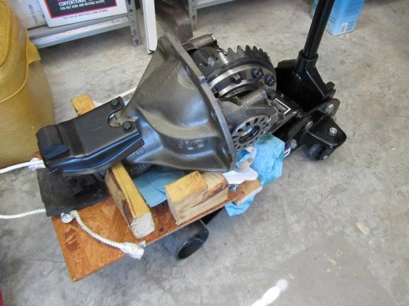

Yeah I would do that but there wasn’t enough room to fit it onto my chest under the car. The exhaust was against my forehead.When I was the OPs age I placed automatic transmissions on my stomach and bench pressed them up into place.

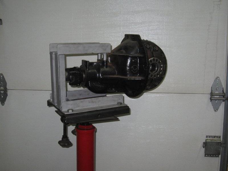

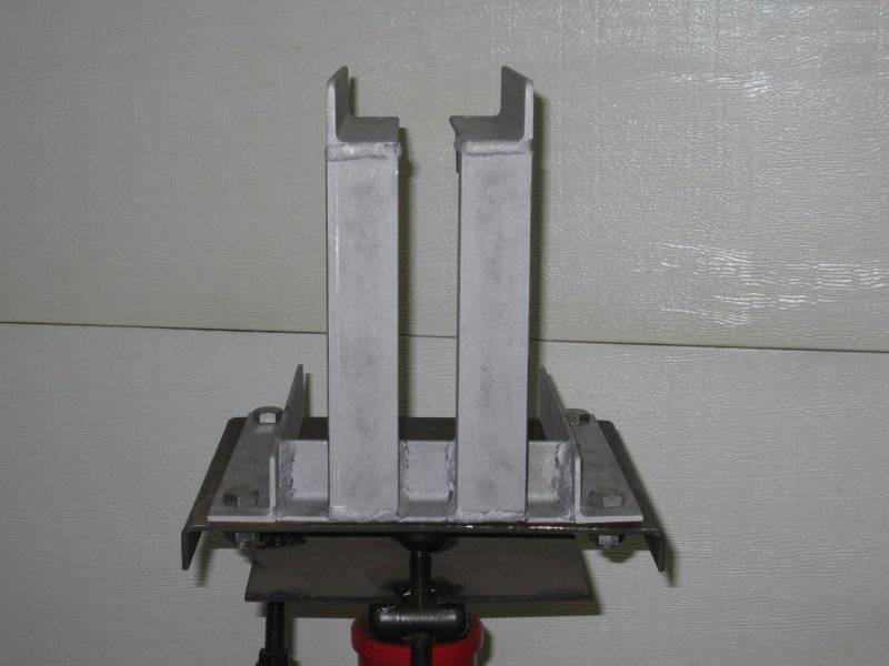

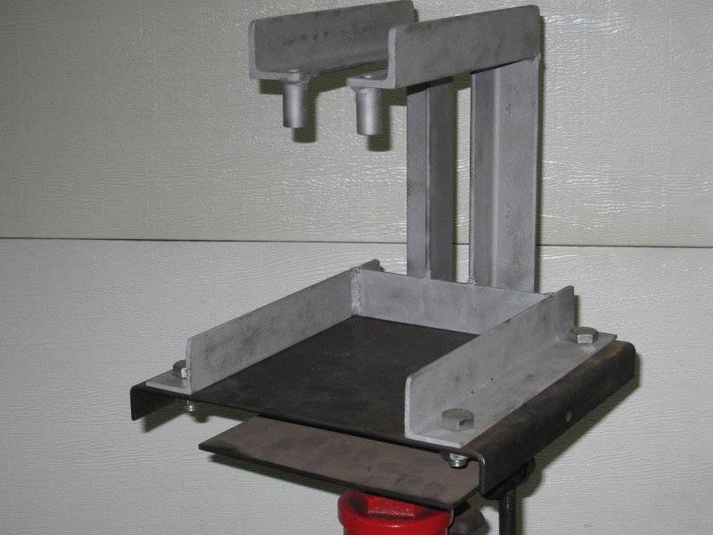

I made a adapter to use with my trans jack but, it would work with a floor jack.
Mike
The trans jack has the adjusters.Very nice. I like.
Any provision to rotate to match housing angle?
Seems like that jig would be easy adapt to a robust floor jack if needed.
But I was much younger when the last one was installed. Like 25 years ago.I have always done this and then just slide it under the car on cardboard or similar and the just bench press it up and in.
I have used that method threw out the years untill approaching the trans in the 06 Ford that thing weights 580 lbs. Not putting that on my stomach.When I was the OPs age I placed automatic transmissions on my stomach and bench pressed them up into place.
parts get heavier the older one gets, no matter what they weighed when one was younger............On the ground, I position the 3rd member close to the rear end, then I lay on my back right under the car, feet towards the trans, head under the housing. Then I roll the 3rd member onto my chest and lift it up to the housing in one motion. Goes right in!
