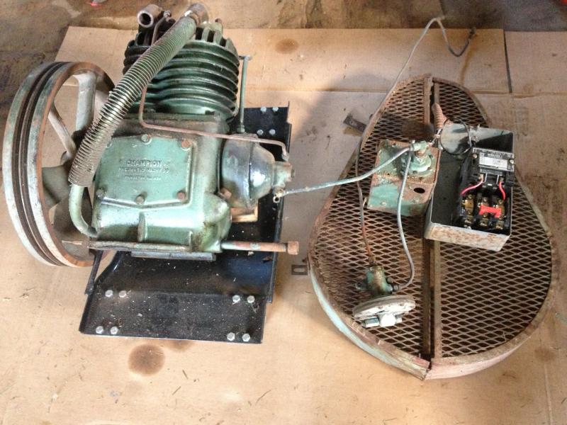

I have an old Champion 2 stage with an 80 gal tank that needs a little work and a motor. I need it gone. PM me and lets see if we can help each other IMG_1250.jpg
