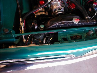

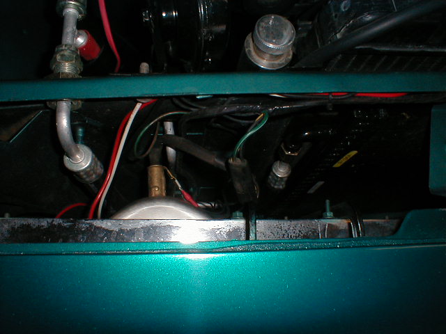

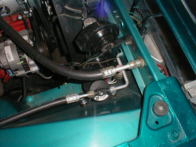

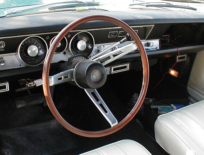

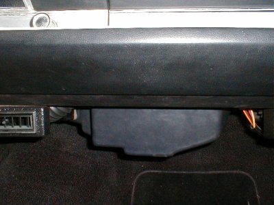

I put the Classic air in my 68 Barracuda convert. If you can work a drill and some wrenches you can put it in, in a day. Mine works great, you need to pull a good vacume before you charge it back up. As you can see I also used a late model GM 120 amp alternator.

Hey Jaws, you're not running that alternator through your original amp gauge are you?
That's a nice install. Do I spy cruise control on that puppy, too?
By passed the amp gauge, now running a volt gauge. Pulled the cruise from a 70 Dodge Monaco many years ago. Fit perfect.
