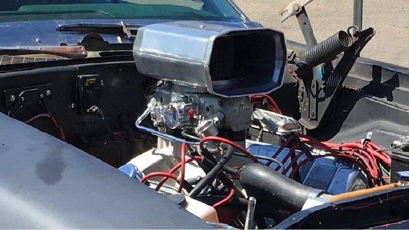

After I put in a air/fuel gauge I got to see a couple things.
Aluminum scoop with small. Round gauze filter would start to run rich at higher rpm. Test without filter did not go rich, so filter did not flow enough air at high RPMs.

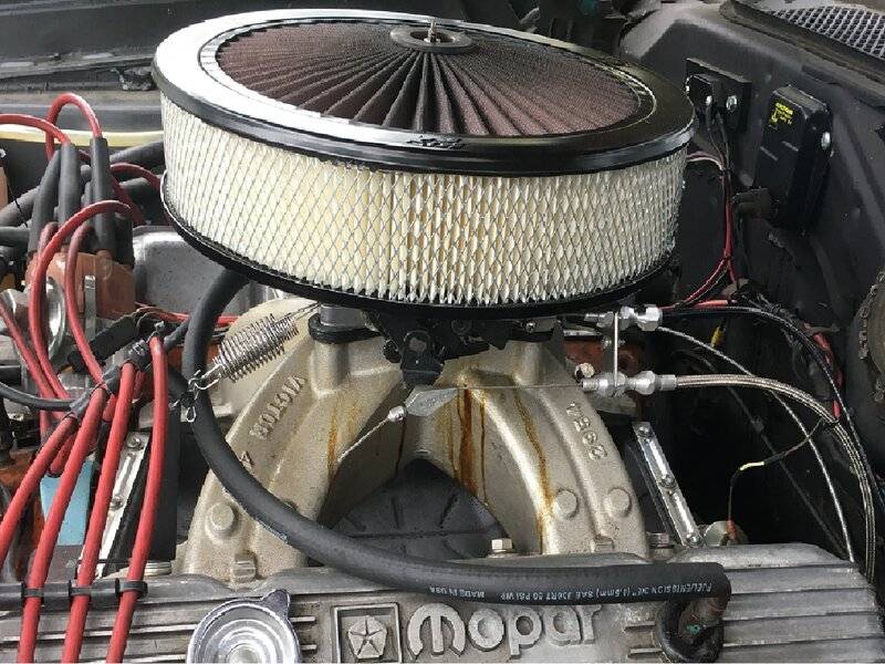

Found baseplate with 2” of drop and 3” filter would cause ratio to flutter at higher RPM. Figured this was from turbulence caused from lid being too close to carb.
Added a K&N gauze filter top that seems to have helped as A/F ratio is steady at high RPMs.
Scoop with small round gauze filter, did not want to cut hood so just ran with it off. Helps keep it cooler also as I vapor lock on hot days.
Managed to fit this manifold under flat 72 Satellite hood w/440 with 2"drop base. Front of air cleaner top barely touches hood, so I still might be restricting air flow a bit.
You got a Victor under a flat hood?!? I'm impressed!
